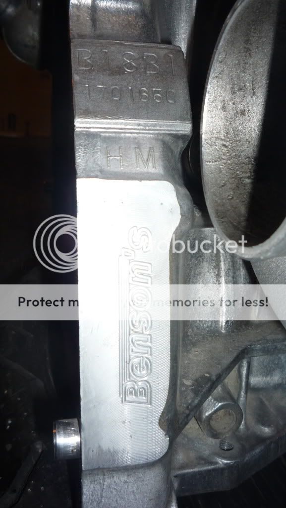

mods done:
Edelbrock Intake Manifold Victor X
bottom end was built by laskey racing
Benson sleeved block b18a 84mm
balanced and micropolished crank
CP pistons and rings with upgraded wrist pins (9:5:1)
Eagle H beam rods rods
ACL Bearings
OEM (TypeR) oil pump
OEM Water Pump
OEM timing belt
Lower gasket set
APR main stud kit
Blueprint and assembly
Block is O-ringed with golden eagle wire
Golden eagle Vtec Conversion Head Dowels
Golden eagle 84MM head gasket
Golden Eagle head studs
Golden Eagle MAIN GIRDLE kit
-Precision CNC machined from 6061T6 billet aluminum.
-With OEM main bolts & washers
-Includes oil pickup and windage tray
-P72 oil panHead is a PR3 head

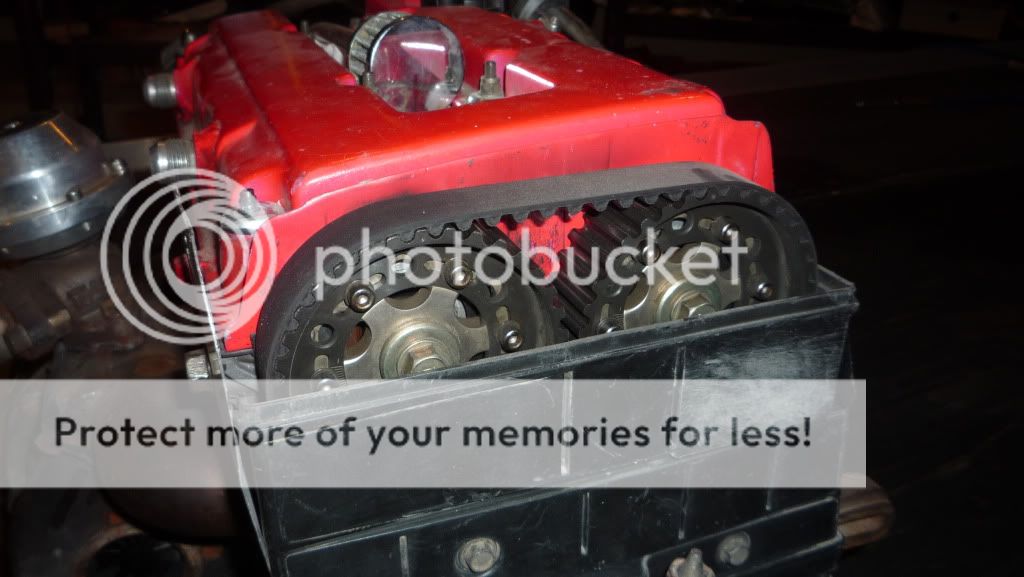

CTR cams
BDL adjustable cam gears

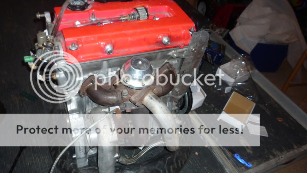

turbo setup just test fitted will be getting new manifold and dp
